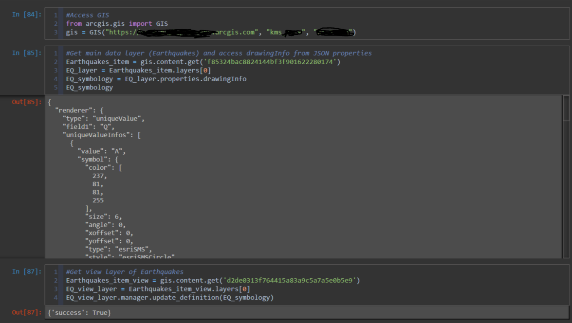

I am testing this with some Earthquake data from an ESRI training course. My idea is to get the JSON renderer/drawingInfo from the main Earthquake layer and update the service definition of the view layer with the main layer. See code below.
I do get a "Success: True" message when I run this, however the drawingInfo properties don't actually update. I have also tried updating a more simple part of the properties (such as description) and that also doesn't update the properties even when the message returns "Success: True". This makes me wonder if I need higher privileges to run this code? I am currently a Publisher, not an Admin in my organization.

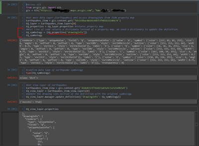

EQ_properties = EQ_layer.properties
Then access the drawing info section of the property map, which will return a dictionary:
EQ_symbology = (EQ_properties['drawingInfo'])
Now you have the correct data type to update the definition of the view layer:
EQ_view_layer.manager.update_definition({'drawingInfo': EQ_symbology})
Screenshot of the code:
