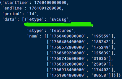

Example 3: Hosted Feature Layer
Item usage via the item page
Item usage via the Python API --- matches the item page

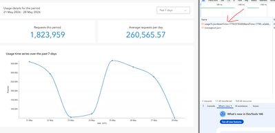

DeirdreSmyth
Hi @mpboyle ,
I have not been able to get the .usage method to work but I did find some information on using the usage REST endpoint - https://community.esri.com/t5/arcgis-online-questions/how-to-get-credit-usage-by-an-application-usin...  this call is about credits but you can do the same for usage.
Essentially it uses the same usage url that the Usage page of an service.
url = "https://your_portal/sharing/rest/portals/<portalid>/usage?"
The you append parameters for the start and end date etc., you can do it with setting parameters and using the urllib
#set parameters of request
params = {
'f': 'json',
'startTime': int(start.timestamp() * 1000), # Adjust start time as needed (e.g., in epoch milliseconds)
'endTime': int(end.timestamp() * 1000),
'period':'1d',
'vars':'num', #gets the usage statistics, can be num, credits or bandwidth(bw)
'groupby': 'name',
'etype':'svcusg',
'name':item.name,
'stype':'tiles',
'token': gis._con.token
# 3. Make the API request
encoded_params = urllib.parse.urlencode(params).encode('utf-8')
req = urllib.request.Request(url, data=encoded_params)
response = urllib.request.urlopen(req)
or in the call above he's constructed the url from variables:
 reportURL = f'https://[your-org].maps.arcgis.com/sharing/rest/portals/[portalID]/usage?startTime={round(enddate.timestamp()*1000)}&endTime={round(enddate.timestamp()*1000)}&period=1h&appId={app_id}&vars=credits,num,bw&groupBy=etype,stype&f=json&token={the_token}'
