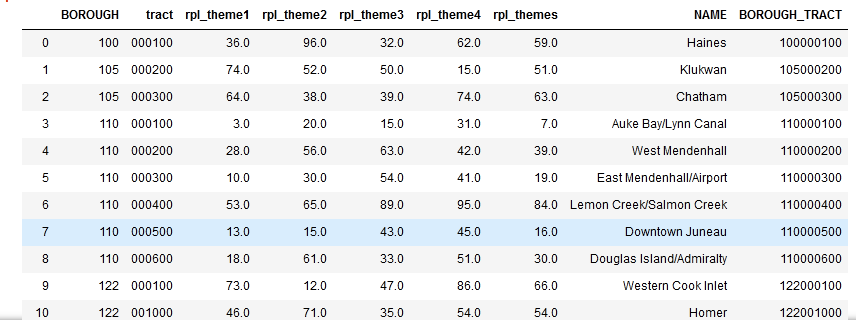

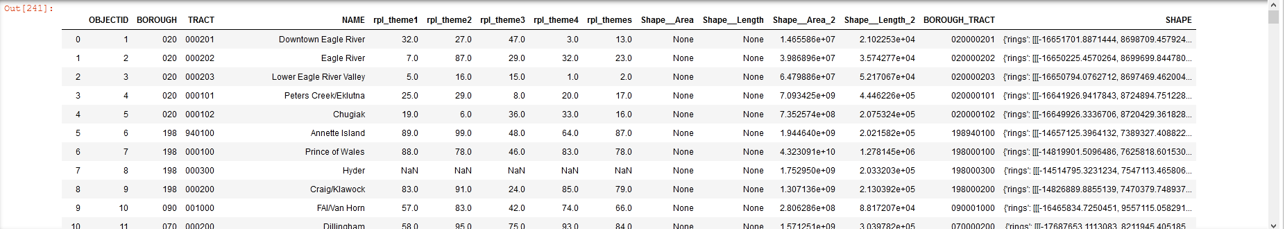

I am trying to update fields in a feature layer using a dataframe that I read in via a csv file in order to update a map on an annual basis. I am not sure how to use the edit_features command to update the fields based on a join of a unique key between the dataframe and the feature layer.
This is what I have so far. I am trying to update the fields rpl_theme1 through rpl_themes but retain the geometry. So I am hoping there is a way to use some code to look for the unique key BOROUGH_TRACT in the feature layer and update the fields using the dataframe.
The feature layer has the following data:
And the dataframe the following:

Hi @MackWood ,
You can follow the link below from esri sample notebooks (Apply updates from the second spreadsheet). This provides a step by step guide from reading a csv file, a feature layer, joining them and finally updating the attribute fields based on your csv dataframe. You just need to skip the geometry updates.
https://developers.arcgis.com/python/sample-notebooks/updating-features-in-a-feature-layer/
I hope that helps.
