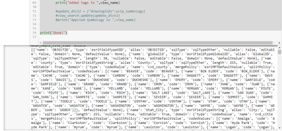

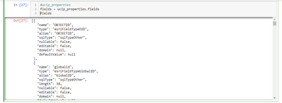

GIS_utahDEM
This is what "fields" looks like:
This is what "dict_fields" looks like
I am looping through each view, with the specific information about that view captured in lines 19-22
