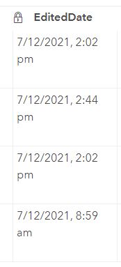

Setting the scene...I have a feature service with one layer and one table, the table is related to the layer. I want to transfer updates from a single field within the last hour from the related table to the layer. Basically updating a status from the related table to the status field in the layer. While the script below runs fine, and the query looks good, it actually picks up edits that are occurring within the current hour rather than honouring the query. If you look below there are four records in the table, three of which are edited after 2pm.EditDate.JPG

Now look at the output for  print statement for the edit_query and the name, num of features...it says that for Area1, which is the EditedDate table above, there are three that fall within 1pm and 2pm, which is incorrect, they fall between 2-3pm, so the output should be "No Feartures"
EditedDate >= timestamp '2021-07-12 13:00:00' And EditedDate < timestamp '2021-07-12 14:00:00'
Area1 3
Anyone come across this before? or offer a better alternative to querying the correct records using the EditedDate field?

Going to guess from your spelling you're in the UK. If so, at this moment the time is as below:
4:51 PM Monday, in Coordinated Universal Time is
5:51 PM Monday, London, UK (GMT+1)
So, it would appear that your queries are being executed in UTC and not your local time zone - at least, this might explain the discrepancy. I run into this frequently with servers in various time zones - the queries go by the system time so there is some offset required at times. You mentioned running the above in a Notebook, but did not say whether that is a local notebook or Notebook Server/ ArcGIS Notebooks. I surmise if you are using Notebook Server/ArcGIS Notebooks the problem may be that the server is configured to use UTC.
So, long story short, you probably just have to account for the offset. Hope this helps!

Thanks @emedina, I thought similar myself. It's currently being run from my local machine with a plan to setup as a Notebook on ArcGIS Online for a scheduled run. I find it odd that the display time in AGOL for the EditedDate field is correct, but accessing the date stored in the field programmatically puts it an hour behind.

I think I may have gotten my wires crossed earlier. I believe the problem is programmatically you have to explicitly supply the offset whereas in the browser the conversion is done for you under the hood. Yes, as you noted in the browser the date appears right but the value is stored in UTC.  Anyhow, this related post should get you going:
https://community.esri.com/t5/arcgis-api-for-python-questions/query-feature-layer-on-date-field/td-p...
