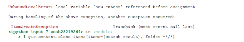

Hello,
I have plently of hosted feature layers that I will need to clone.

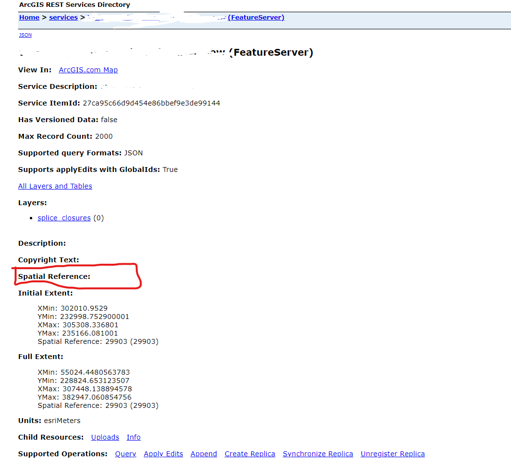

The problem is that the service of the hosted feature layer does not contain a Spatial Reference, while the sublayer does
When I try to use the clone_items() command I get the following error :
I am sure that the problem here is the missing Spatial Reference of the hosted layer because if I try to clone another layer that has a defined Spatial Reference, everything goes as supposed.
Is there any way to update the service with the Spatial Reference or to choose the output CRS of the cloned layer so I bypass this error ?
