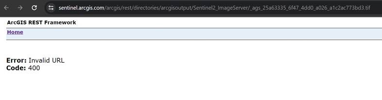

Problem: This solution works sometimes and doesn't work sometimes. When it doesn't work I get Invalid URL error -Please see below- (Example of generated URL: https://sentinel.arcgis.com/arcgis/rest/directories/arcgisoutput/Sentinel2_ImageServer/_ags_f2acff29...

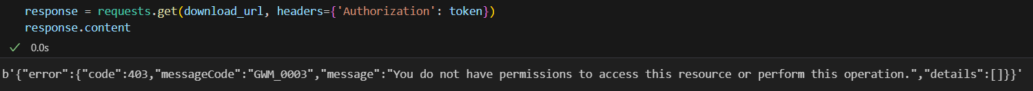

Solution3: I decided to try ArcGIS REST API as in https://developers.arcgis.com/rest/services-reference/enterprise/download-rasters.htm
Problem: "Not having enough permissions" so I contacted our enterprise Admin they keep running into "Requested operation is not supported by this service" error, code 400 and extended code is -2147220222.
