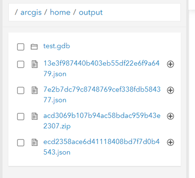

Which results in something like the following (ignore that 'test.gdb' item):

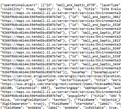

Any of which, if you opened up, would have the full JSON of the web map.
