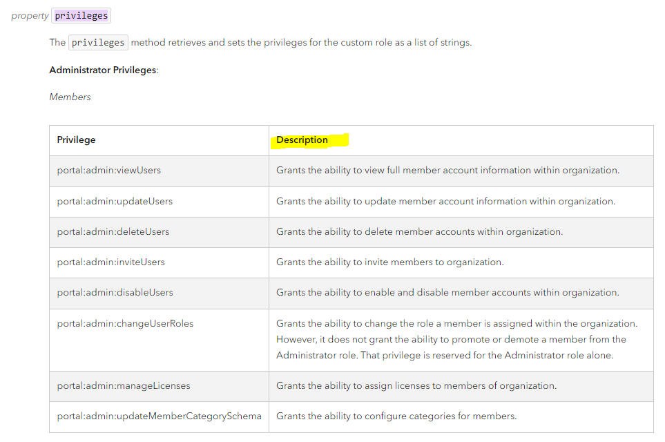

I'm attempting to inventory the permissions that have been enabled for roles in our enterprise portal.  It's straightforward to get the permissions for a given role, and I end up with a list of what seem to be permission id's. For example, one of our roles returns this when I print the permissions:
['features:user:edit', 'portal:user:joinGroup', 'portal:user:viewOrgGroups', 'portal:user:viewOrgItems', 'portal:user:viewOrgUsers', 'premium:user:demographics', 'premium:user:elevation', 'premium:user:geocode', 'premium:user:networkanalysis']
These permission ids correspond with tables in the developer documentation Role: ArcGIS API for Python and include an easy to understand description of what the permission actually does (example below).
My question is:  Are these descriptions accessible from the API anywhere?  I'd like my script to be able to output these descriptions so the inventory is more readable.
Thank you in advance!
Kristen
