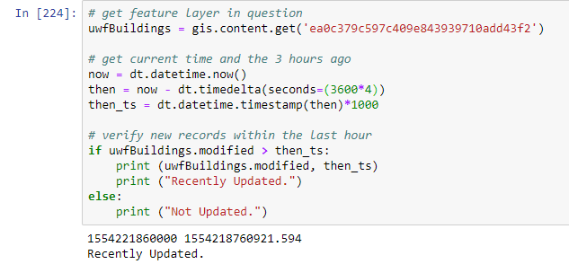

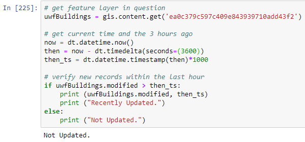

I will manually modify the feature layer (add in a polygon), allow the feature layer to save, verify in the feature layer properties that it recognizes the modification, and then run the script, but the modification isn't recognized.
I am not sure if it's because I live in the Central time zone and the then_ts variable is simply converting Central time to UTC while uwfBuildings is strictly UTC or what, but it's doing my head in.
If I change the seconds variable for then to (3600*4) - for four hours ago - it will recognize that a change has been made, even though the change I made last was 30 min ago:
I'm concerned that it is not possible to get the time resolution for the last modification for a feature layer to within an hour. If there is, how?
