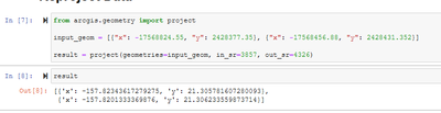

I hate to be this guy, but when I run your code, I get a successful result.
I haven't modified anything, as you can see.
Where are you running this code?
Also, if the source is a service, you can specify the output SR in the query function, which may help here.

I am glad tht you are the guy and you ran it! At least and module should work!
I ran it in PyCharm and i tried it again. It seems that it need one to login arcgis.gis t run. as soon I added logged in, it works now:
from arcgis.geometry import project
from arcgis.gis import GIS
gis = GIS(url="https://www.arcgis.com", username="me", password="that")
input_geom = [{"x": -17568824.55, "y": 2428377.35}, {"x": -17568456.88, "y": 2428431.352}]
result = project(geometries=input_geom, in_sr=3857, out_sr=4326)
print(result)
I will run it with my data now!
Thanks!
