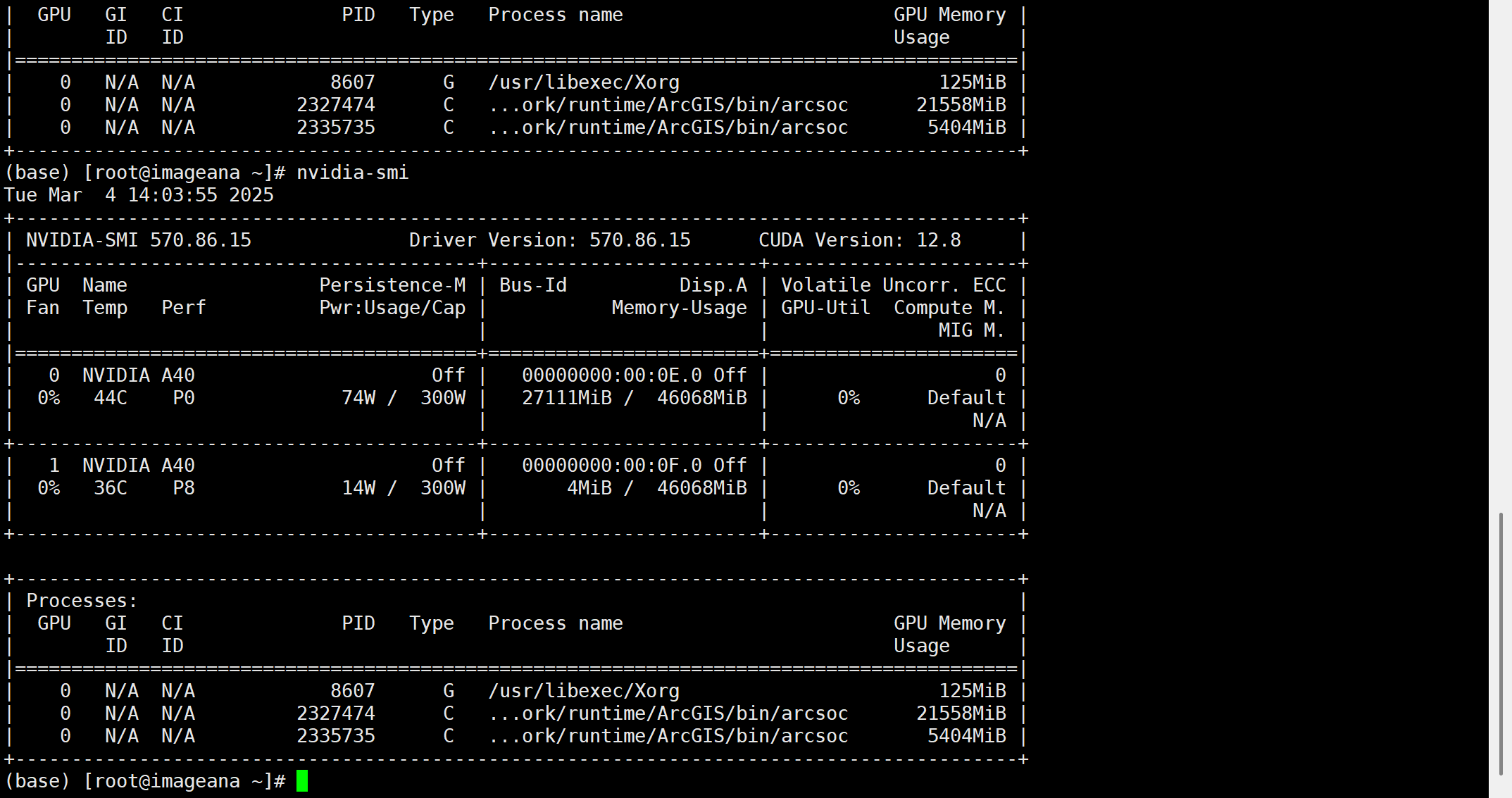

l used arcgis python api to perform deeplearning inference tasks. When one task successed, proceed to another task, the job of RasterAnalysisTools failed. Job messages prompted GPU memory is occupied.
l found instance of RasterProcessingGPU  do not release GPU memory.
l tried some ways but not optimal.
1. Adjust RasterprocessingGPU service recycling interval to short time
2 Restarted  RasterprocessingGPU service after each execution of the script.
But my question is  instance of service can release GPU memory automatically ?
