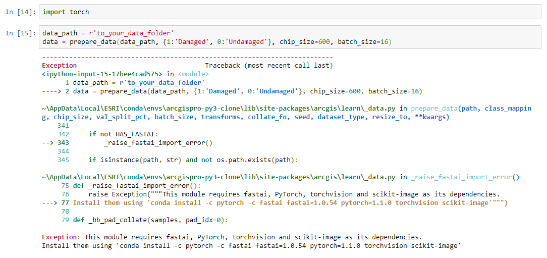

When I try to follow the steps in one ESRI sample notebook. It indicated that I don't have the required packages which I have already installed. Does anyone encounter this issue before? Any feedbacks would be appreciated. Thanks!

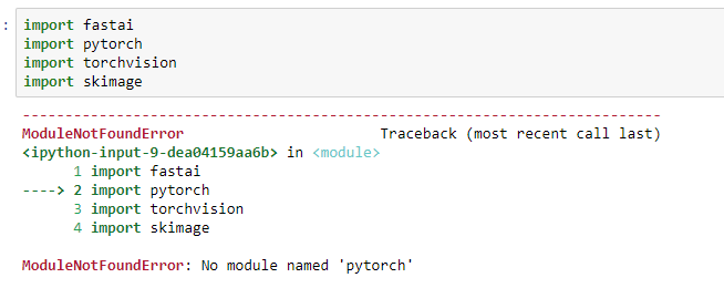

The ArcGIS package has been upgraded; however, failed to import pytorch (the other three are good).

as i have written in my previous message do this
import torch

I would suggest you to create a new cloned environment from default environment, it might be better to start on  a clean environment.
and use this command to install the required packages
conda install -c esri arcgis fastai scikit-image pillow --no-pin
