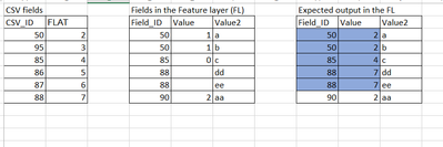

The aim is to replace the records in the field called "field1" of the feature layer (fl) based on a record from a field called "FLAT"  in the csv file. The two common IDs in the feature layer and the csv file are Field_ID and CSV_ID, respectively.
Nahomdinka
@HuubZwart  Here is what it looks like
