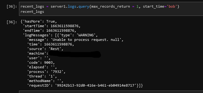

 comparing to the GUI in Sever Manager I'm not lining up these times with anything. I can supply any argument I want for start_time and no error is returned:
If I leave out the 'start_time' parameter entirely, the query returns exactly what I'm seeing in the Server Manager GUI exactly.

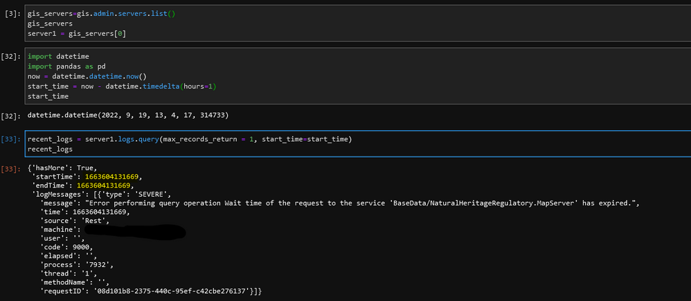

If I only filter for a start_time of 1 day ago i'm getting back hundreds of entries going back a month or so.
now = datetime.datetime.now()
StartTime = now - datetime.timedelta(hours=1)
StartTime
ServerLogs = server1.logs.query(level = 'SEVERE',start_time = StartTime)
ServerLogs
If i use the GUI in Server Manager with the same filter, I see 4 entries.
Any querying from the API and the Portal log GUI however match exactly.

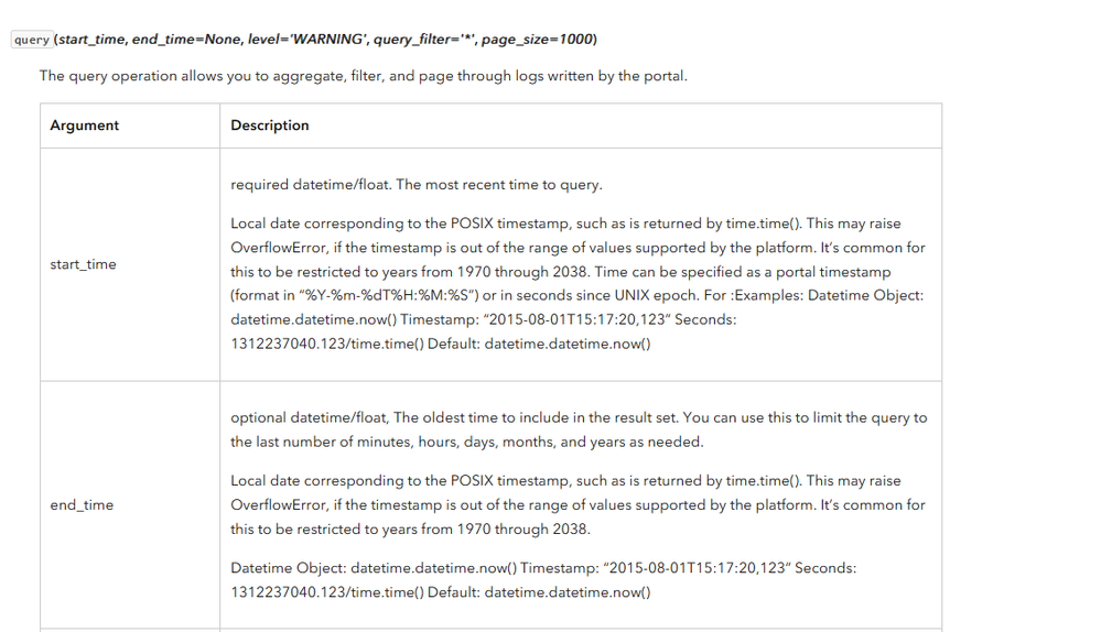

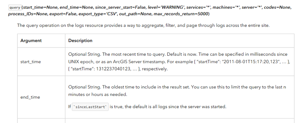

The reference documentation for arguments is slightly different from Portal to Server however...
