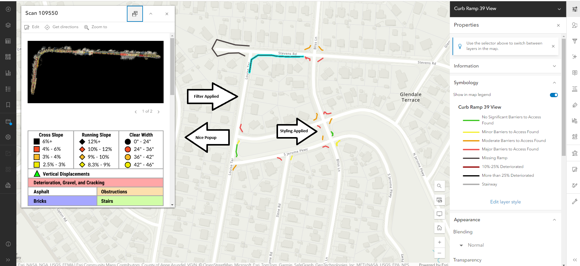

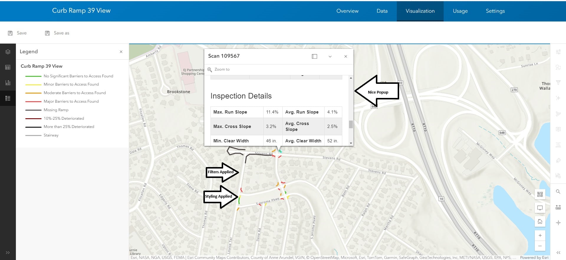

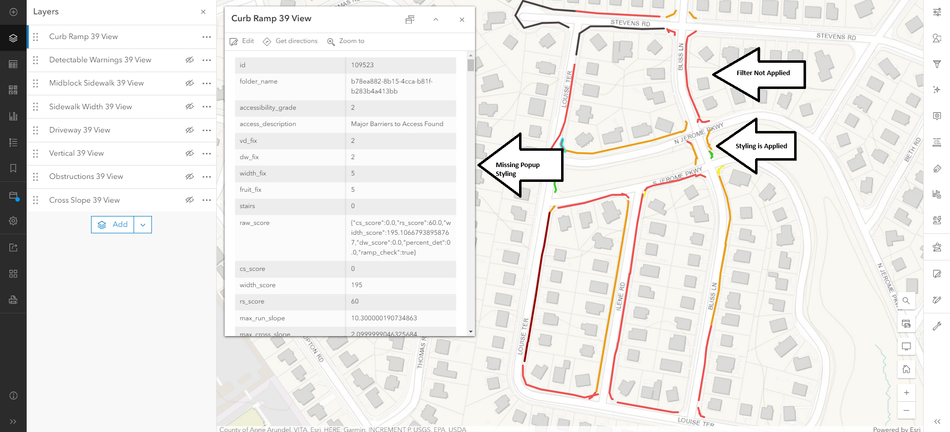

The styling, filters, and PopupInfo from the template are visible on the View visualization tab and when creating a new web map from that view. Only the styling is visible on the programatically generated web map, not the filters or popup formatting.
Visualization Tab
New Web Map Made from GUI:

Python API Web Map:

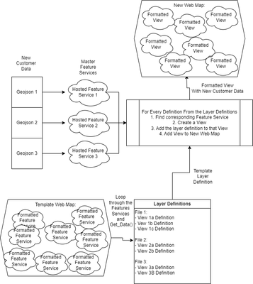

This is great! I wish I knew about this before I started working on this. We have a super similar workflow. Here's a diagram of what I'm trying to do for reference.
It looks like the main difference is that you are adding components of the template definition piece by piece and I'm just pasting the whole definition in there. Is there something else that I'm missing? I'll try to implement your approach and see if it fixes it!
