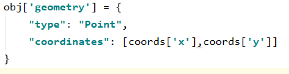

I'm loading data from a GeoJSON object in python. I'm sure I am properly assigning my point coordinates in "geometry" key like this:
and creating a featureSet from the cases dict (GeoJSON)  and load it to my hosted feature layer in AGOL.

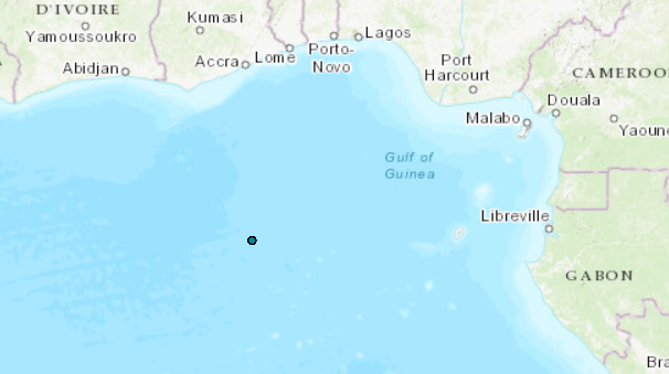

But in my AGOL's map viewer, all points are concentrated in [0,0] coordinates. Checking the service URL, whenever I query the features and return them in HTML or in JSON format, it shows the correct (x,y) geometry. But when I return them in geojson, it shows wrong (x,y) values. Any idea how this is even possible? Thank you!

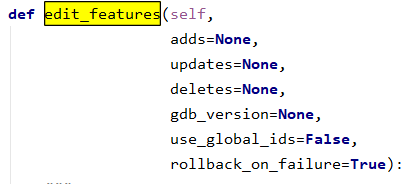

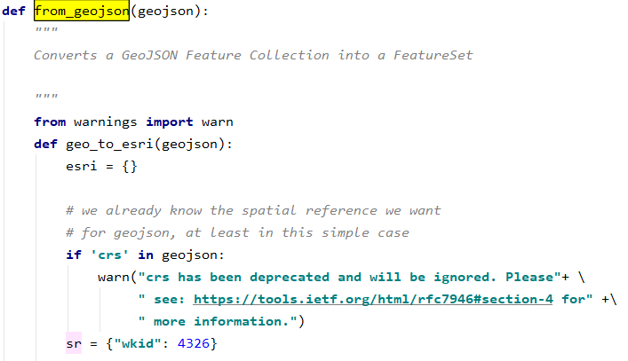

I am looking into this module (arcgis.features module — arcgis 1.8.0 documentation ) and trying to look for a function that can convert the spatial reference of my input featureset, but spatial_reference is the only available one from the list. I tried including the datum_transformation when I'm calling the edit_features() but getting this error instead.
Checking the module show me this in the layer.py
Checking the from_geojson method in feature.py show me this.
Is there an available method/function that will transform my featureset to the 3857
