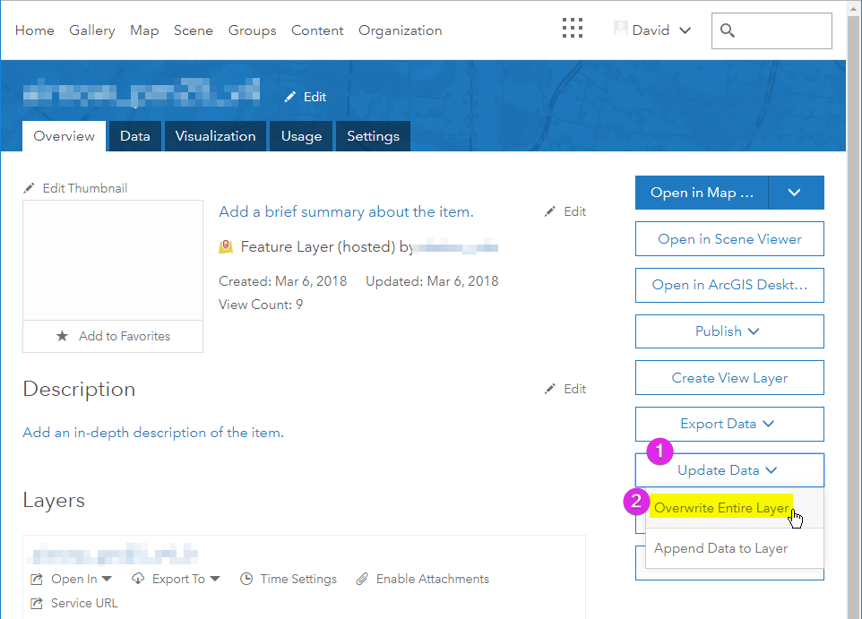

Manually, it's really easy to do this (see screenshot). I initially loaded a GeoJSON file to AGOL. I find its hosted feature layer, click on "Update Data", select the overwrite option, select the new file, and it's all taken care of. This is the process I'd like to automate.
