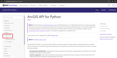

And what's the best place to find release annoucements to track what has changed between releases?
NicholasGiner1
Hi @A_Schwab - this fix was introduced with v2.4.0.
Any time we release a new version of the ArcGIS API for Python, we include full release notes, as well as a "what's new" blog that summarizes big ticket items and main themes.
