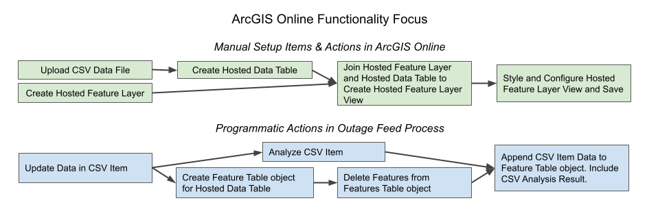

This is the flow for a process we have automated. The blue portion is the programmatic portion.
This was developed after encountering issues with the .overwrite() method. See my earlier reply, though I hadn't gotten the append method to work at that time. Hope this helps.
Power Outage Application - Cloud Model - Process Flow clipped for agol answer.png
The programmatic portion of the process goes as follows:
Create a connection object: gis_connection =
arcgis.gis.GIS(your info)
Then get csv item by id:
gis_connection.content.get(itemid=item_id)
Update the csv item using a local file (because the process requires a path):
csv_item.update(data=temp_csv_path)
Get the hosted table item by id:
Create a feature table item:
arcgis.features.Table.fromitem(hosted_table_item)
Analyze the item:
gis_connection.content.analyze(item=csv_item.id)
Delete the existing features:
features_table.delete_features(where="1=1", return_delete_results=True)
Append the new data:
attempt_ceiling = 3
for i in range(0, attempt_ceiling):
try:
append_result = self.features_table.append(
item_id=self.csv_item.id,
upload_format='csv',
source_info=self.analyze_result,
upsert=False,
except Exception as e:
# Esri exception is generic so there is no specific type to look for.
print(f"ATTEMPT {i + 1} OF {attempt_ceiling} FAILED. Exception in ESRI arcgis.features.Table.append()\n{e}")
time.sleep(2)
continue
else:
print(f"Append Result: {append_result}")
break
 NOTE on the Append portion:
Esri update of an existing hosted feature layer using append functionality
NOTE:
The append function periodically throws an exception, and the ESRI code is not specific and is just
a type Exception. Was occurring 1-3 times per day out of 97 runs. Added a loop with sleep to introduce a
small amount of wait before retrying the append. Features in existing hosted table have been deleted prior
to the appending of new records so important to not fail out and leave an empty table in cloud.
