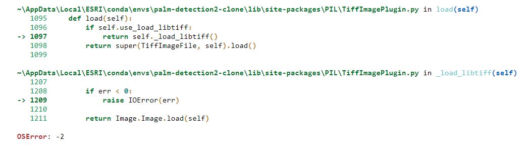

Hi,
I'm trying to apply the Deep Learning methodology illustrated here Extracting Building Footprints From Drone Data | ArcGIS for Developers to my own data. But I'm getting the following error
The command I used was this:
The conda environment that I was working was installed with the following command
 'conda install -c esri arcgis deep-learning-essentials --no-pin'
Anybody know a solution to this?
Vishnu_maheshVivek_nanda
I think I realize what the error was. I was trying to run the command from a different environment than what was used while exporting the training samples.
by Anonymous User
Not applicable
This issue is usually raised because of a broken pillow installation, you can use the following command to fix the environment.
remove pillow using the command "pip uninstall pillow"
install back pillow using the command "pip install pillow==6.2.1"
Also, please check for the current pillow version supported by ArcGIS Python API while installing back pillow.
