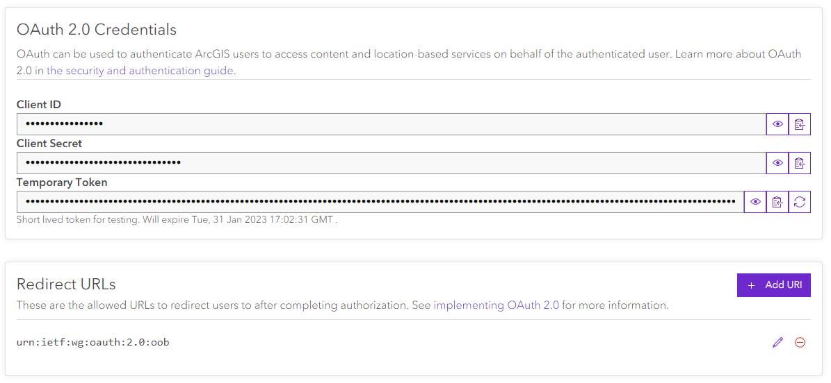

I am trying to use oauth2 with python in order to get a token that will allow me to query content in my organization with the arcgis library. Everything works correctly, except the fact that when I sign in to ArcGIS Online with the oauth2 token, I only have access to the public items.
I am administrator in my organization and I have created my oauth2 application in developers.arcgis.com
