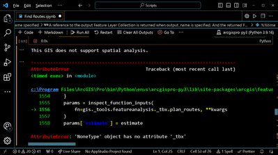

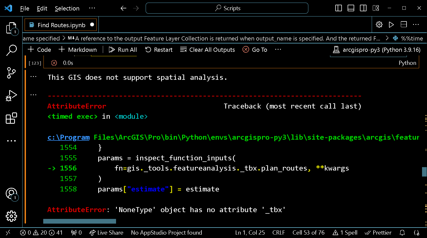

I have been trying to run the code on this page in a notebook;
https://developers.arcgis.com/python/guide/part2-find-routes/
it worked fine until I got to this section:
With output_name specified
I got this error using the exact code on this page.
I installed my API with ArcPro and run it from VS Code the other code before this worked just fine.
This GIS does not support spatial analysis.
AttributeError Traceback (most recent call last)
<timed exec> in <module>
c:\Program Files\ArcGIS\Pro\bin\Python\envs\arcgispro-py3\lib\site-packages\arcgis\features\use_proximity.py in plan_routes(stops_layer, route_count, max_stops_per_route, route_start_time, start_layer, start_layer_route_id_field, return_to_start, end_layer, end_layer_route_id_field, travel_mode, stop_service_time, max_route_time, include_route_layers, output_name, context, gis, estimate, point_barrier_layer, line_barrier_layer, polygon_barrier_layer, future)
    1554 }
    1555 params = inspect_function_inputs(
->1556 fn=gis._tools.featureanalysis._tbx.plan_routes, **kwargs
    1557 )
    1558 params["estimate"] = estimate
AttributeError: 'NoneType' object has no attribute '_tbx'
