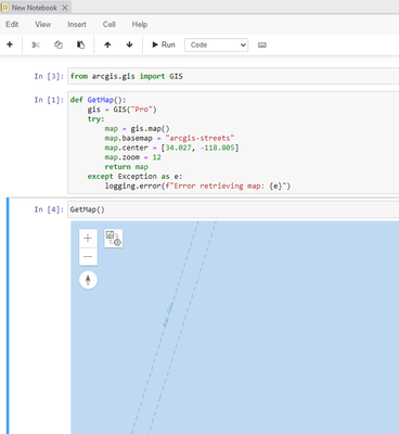

BijanTaheri
Hi,
I ran your code in a new ArcGIS Notebook in Pro, and it worked fine. I'm on ArcGIS Pro 3.3.1 and ArcGIS API for Python 2.4.0. What versions of python/arcgis api for python are you working with?
The code if very simple and should work without problems, maybe it is the rest your code that tries to use the notebook.notebookapp module?

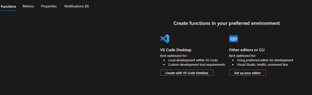

RogerAsbury
I'm gonna update this because it has now been two weeks of severe annoyance and zero real progress. I'm hoping someone more familiar with these things than myself strolls in here. 🙂
1. The no matching distribution found error went away after I upgraded my local version of Python to 3.11.
2. However, this would then stall when the deploy from VS Code got to the section "Running pip install", eventually timing out without error.
3. This was solved by creating a ci/cd pipeline in Github to autodeploy on a new code push.
4. This seemed to properly build and deploy to the server, but the server seems to think it doesn't have a function app, per the attached image.
5. The code is there, so I have no idea why it isn't running. Server response is a 404 error.
So, still no idea what's going on, or why things aren't working...
Edit to add - If I run it locally from VS Code, this function works as expected, for what it's worth.

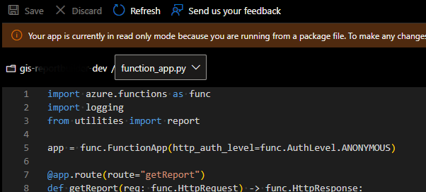

RogerAsbury
Soooo, after more testing today, I can say the following:
1. Commenting out "from utilities import report" and any associated calls to report, allows the function to be seen by the function server and run, though obviously not do much.
2. Adding "import requests" immediately sends it back into a 404 status, even if I don't utilize the requests library. If I do, say to make a simple call to a website, it still 404s.
3. These were not issues when utilizing the older version of Python and Azure V1 function app model. Though obviously the original error existed...
