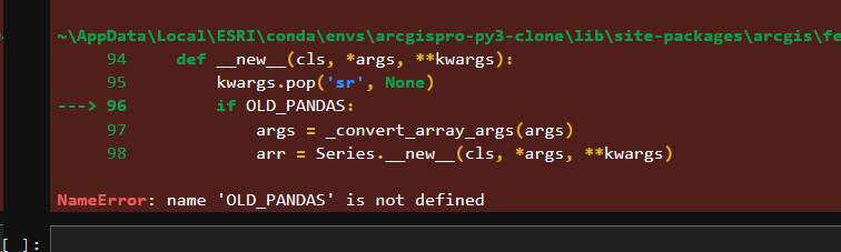

Hello,
I am trying to convert a FeatureLayer object into a SpatialDataFrame object but am running into a strange error:
NameError: name 'OLD_PANDAS' is not defined
Any ideas what is wrong or how I can fix this?
I have imported the requisite packages I believe;
Many thanks

Given that the ArcGIS API for Python is still fairly new, there are some big changes that can occur between releases, so it is important to say specifically which version you are working with.
Looking at Introduction to the Spatially Enabled DataFrame | ArcGIS for Developers:
New at version 1.5, the Spatially Enabled DataFrame is an evolution of the SpatialDataFrame object that you may be familiar with. While the SDF object is still avialable for use, the team has stopped active development of it and is promoting the use of this new Spatially Enabled DataFrame pattern. The SEDF provides you better memory management, ability to handle larger datasets and is the pattern that Pandas advocates as the path forward.
I would focus your effort on learning the new data frame rather than troubleshooting the older spatial data frame.

BenjaminSperry1
Thank you very much for the response. I hadn't realized the change.
I am using the arcgis v 1.5.2
pandas v 0.24.0
I am not familiar with the spatially enabled data frame object but after following the guide I am getting the following error:
I tried it with several different feature layers including a very simple one with no dates and it always gives me the same error. Am I missing something?
Here is the full error message in case it helps:

Exactly the same error message yesterday when I added GeoPandas to Python using Conda over the ArcPro 2.3 version.  I then upgraded to ArcPro2.4 which removed GeoPandas and now the Python Script needed to be upgraded to the latest version and the script is running.  It seems to me that GeoPandas and its dependencies conflict with ArcPy and ESRI's other installed dependencies.
But we maynot need GeoPandas implementation to manipulate teh AGOL features, so fo rthe time being I will forgo that install.
