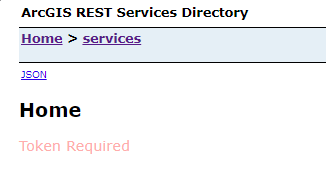

I cannot run scripts to AGOL and I suspect MFA is the issue.  Are there ways to utilize scripts with MFA implemented?  I use to use scripts like below to access REST services, and generate tokens for the irritating "Token Required" message at REST endpoints for services I published while I am online:
params = {'f': 'pjson', 'username': userName, 'password': pw, 'referer': 'https://www.arcgis.com', 'expiration': 21600}
tokenURL = 'https://www.arcgis.com/sharing/rest/generateToken'
response = requests.post(tokenURL, data = params, verify = False)
token = response.json()['token']
