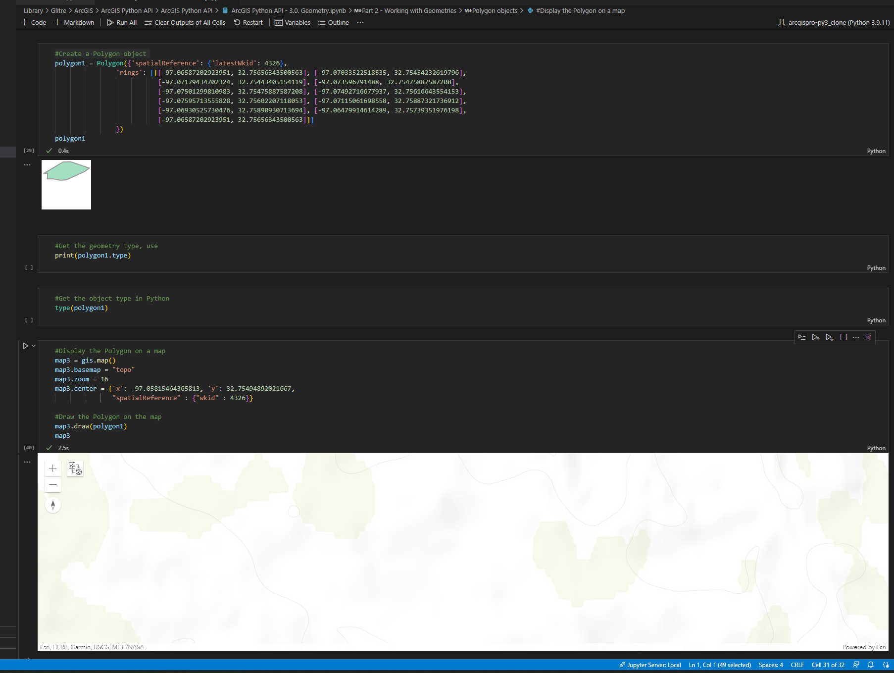

I have the same problem every time I try to display a map in Python. Im using Notebook inside CS code.
The map is drawn but the center is not where I specified it to be.
Also the defined polygon is not displayed dispite I wrote the code to display it.
The map is displayed but not the polygon and the map center is wrong, se the attached image.
Can someone see if I did something wrong?

I have a similar problem with the 'center' function - it does not change the map parameters
