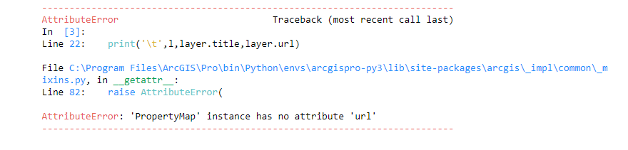

It works fine when just listing the Title of the layers, but when I had a parameter to print the layer.url as well as the layer title:
     "print('\t',l,layer.title)
I get the following error:
This occurs when trying to get the URL for a third party, public WMTS layer, in the Web Map.
Can I modify the code to ignore this error, or list something.

You can use Python try/except statements to handle the error gracefully and continue with code execution.

It looks like the URL property is specific to certain kinds of items. Maybe try item.homepage
