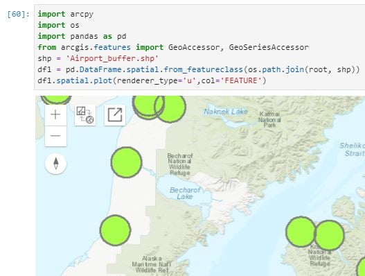

Hello Fellow GISers,
I have created a simple spatial.plot in Jupyter Lab notebook of a single local feature class.  See image below for code and output.  What I'm struggling with is adding another feature class to the same output (same map widget).  I would prefer to keep it simple like below and not open a connection to ArcGIS online, especially since my feature classes are local.  Any ideas?  Thank you.
Tyler
MehdiPira1
Hi Tyler Townes‌,
you can create another spatial dataframe and plot it to the same map widget:
df1 = pd.DataFrame.spatial.from_featureclass(path to feature class1)
df2 = pd.DataFrame.spatial.from_featureclass(path to feature class2)
mp = gis.map('area of interest')
mp
df1.spatial.plot(map_widget = mp, renderer_type = 'u', col = xxxx)‍‍‍
df2.spatial.plot(map_widget = mp, renderer_type = 'u', col = xxxx)‍‍‍
