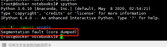

Jupyter kernel always restarts when training PointCNN model.Maybe cased by large IO requests,I don't know.Has anyone meets the same issue?
Platform (please complete the following information):
  • OS: [centos]
  • Browser [chrome]
  • Python API Version [1.8]

Try it in another python IDE to see if it is just jupyter

LinoSun
Since it is a Linux system, you cannot install arcgis pro.And an error occurredt  when executing code on linux system.
Is this error related to my system?

I would recheck the documentation
Install and set up | ArcGIS for Developers
and specifically here
System requirements | ArcGIS for Developers
There is no requirement to have Pro installed... as per the note
Note: if arcpy is found in the current python environment, it may be used in various locations. Otherwise, pyshp will be used. See SpatialDataFrame for more information.
There are python IDEs for linux

After I changed the system to windows, the problem was solved.Thanks very much.
