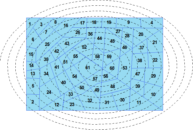

J'ai une couche d'entités polygonale que je voudrais numeroter automatiquement mais en spiral (En escargot). De facon à avoir une continuité par voisinage. je suis un debutant en python, merci de m'aider. Merci
12598
26
02-21-2018 12:42 PM
NedCharles
J'ai une couche d'entités polygonale que je voudrais numéroter automatiquement mais en spirale (En escargot). De facon à avoir une continuité par voisinage. je suis un débutant en python, merci de m'aider. Merci

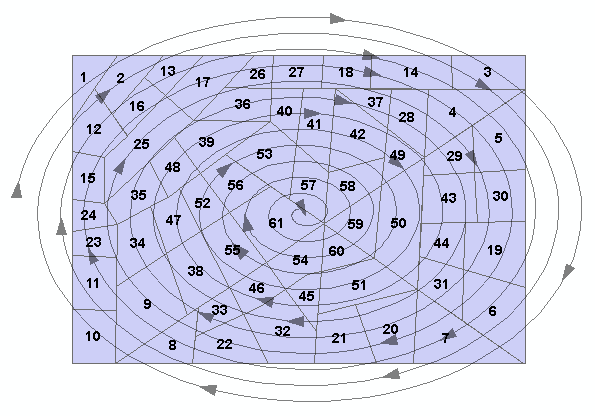

Interesting what you can get if you don't create a "rectangular spiral" as in the image the OP provided, but just follow the line of a somewhat oval spiral (since the input area is a rectangle and not a square):
However, this is not what the OP wants...
I do think that the spacing used between the lines of the spiral will influence the resulting order. This might be something to look at.
XanderBakker
Esri Esteemed Contributor
Just to add some explanation of what I did. I created two scripts, one to create the spiral and the other one to order the polygons.

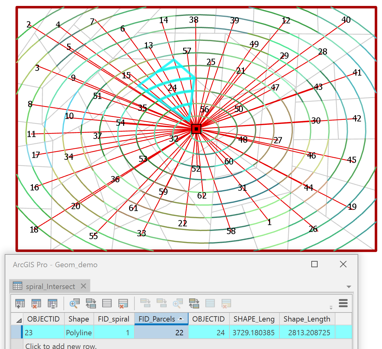

Just to validate if it crosses all the polygons I manually did a select by location (but you can easily script this too).In case it doesn't select all the parcels, one should play with the values for pnts_cnt and pnts_div which define the number of spins.
In case it does select all the second step is to define the order of the parcels. This is done by first performing an intersect between the spiral line and the parcels. This too I did manually, but you can script this also. The resulting line featureclass will have all the intersecting segments. Next you will have to do a Multipart to Singlepart to ceate a feature for each part.
The order is then defined by the second script that validate the center of the segment on its position on the spiral. The lower this position (0-100%) the lower the assign value for the order.

The result will look like this:
Since your spiral is more rectangular, the code would have to generate the "spiral" in a different way.
