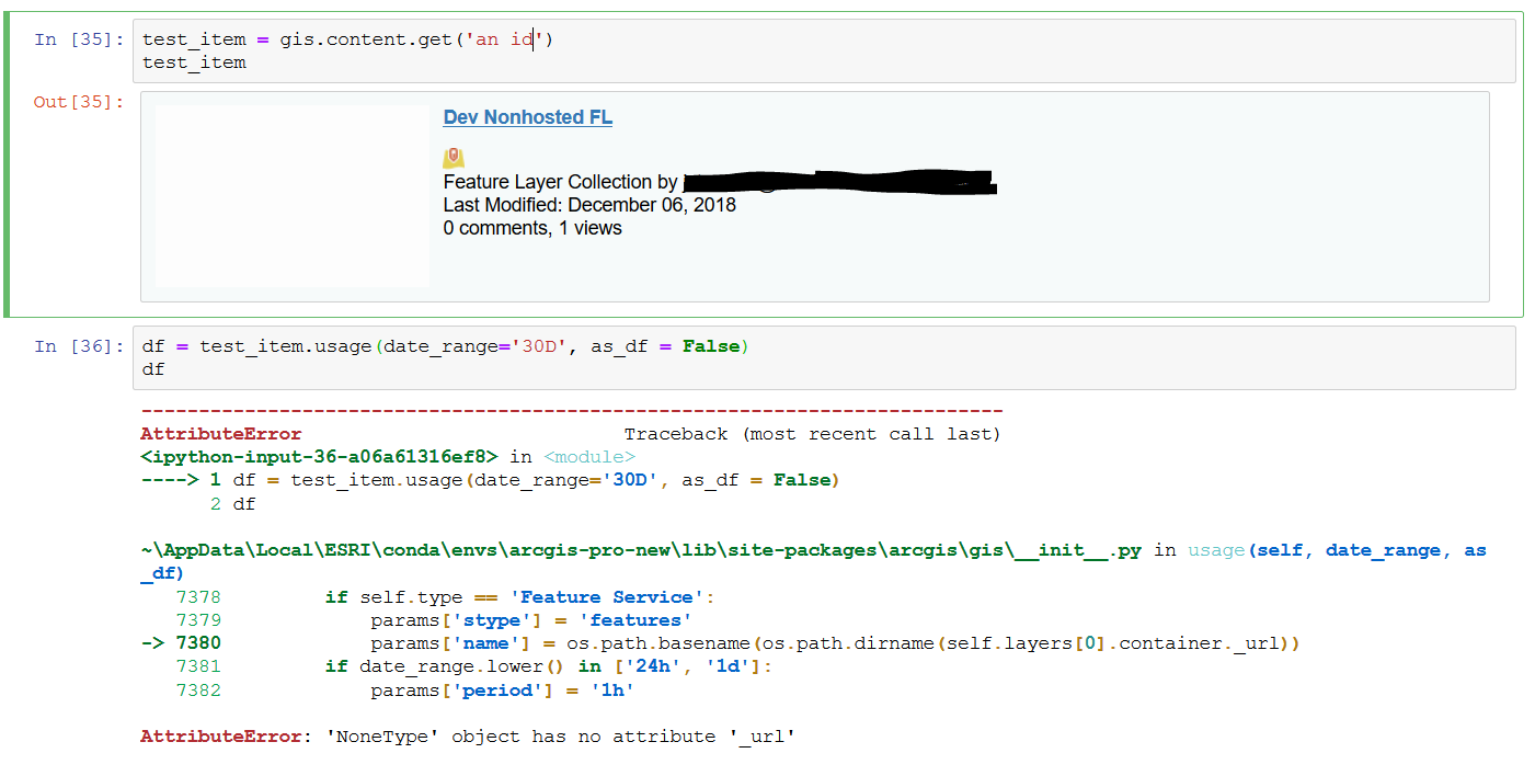

  1. This operation seems to work for all item types except for nonhosted feature layers that have been registered from ArcGIS Server. Hosted feature layers are fine. The documentation implies that this is supported ("For maps, scenes, nonhosted layers, and web apps, the view count is increased by one when you open the item page or open the item in Map Viewer.")
    In the example below, I registered a publicly available ArcGIS Server Feature Layer (Layer: Continental US Labels (ID: 1) ) and get the following error:

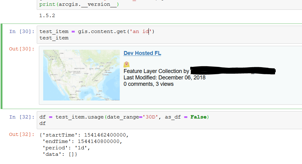

  2. Why do the "number of views" in the item details not match up with the item usage? In the example below I created a hosted feature layer, added it to a map and made an edit. This seems reflected in the "3 views" in the item details but the usage for the last 30 days is empty.
