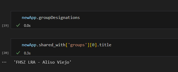

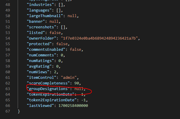

Group Designations
It appears that however Esri has intended this to function the groups that an item is shared with is not recorded in the item's properties.
See the item's JSON via the assistant below, where there are no values for groupDesignations (even though this is in fact shared).
And below, where there is a workaround to call it via .shared_with(), but it requires pulling it out of a list.

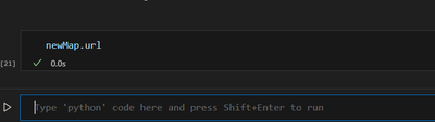

Web Map URL
How else can one pull the web map's URL? item.url pulls nothing. And scanning the item's JSON it doesn't appear that the URL that it lives at is stored anywhere. What other methods are there to capture and store the map's url in a table? (Calling .url for the other item types works just fine).

For the groups, maybe you can do:
", ".join([group.Title for group in item.shared_with["groups"]])
And this would handle cases where the an item is shared to multiple groups.
