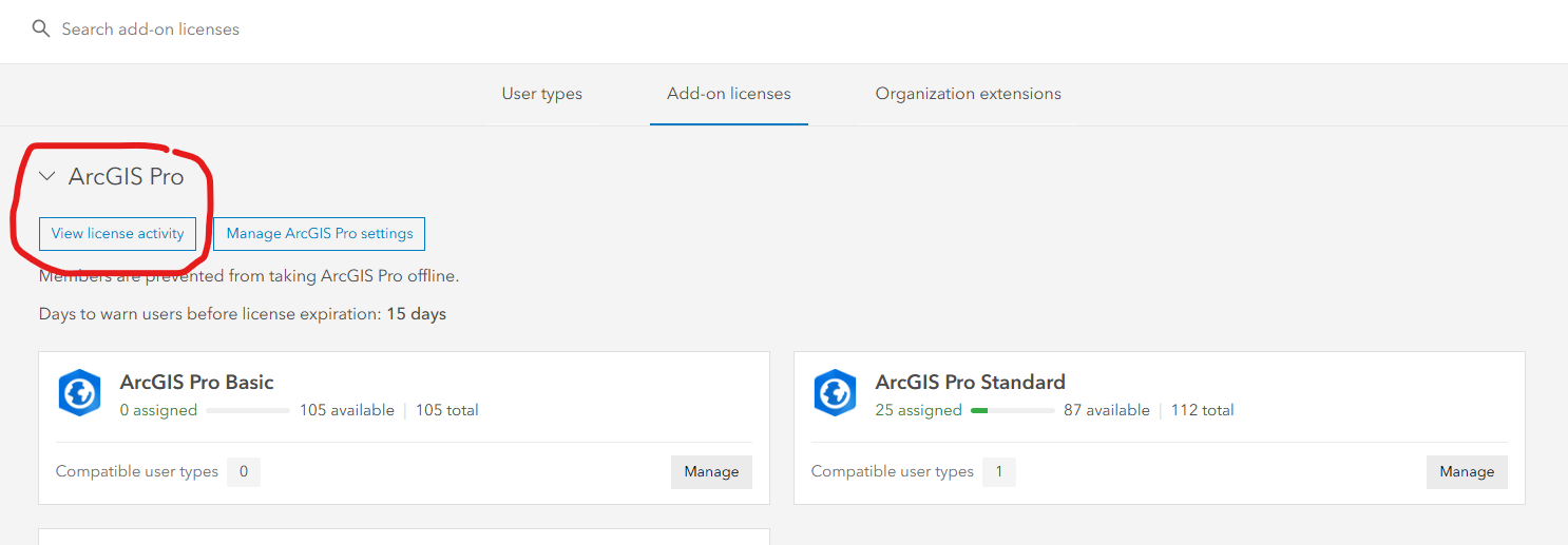

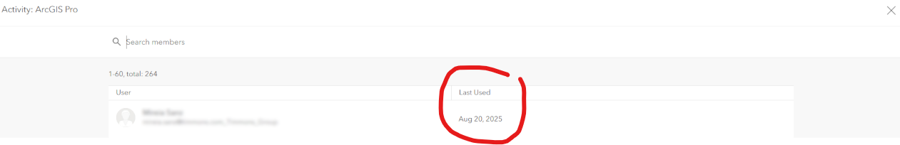

Hello,
I found this related post but no answer from it, wondering if there are any other insights.
I was hoping to be able to write a Notebook that would use the ArcGIS API for Python and query the license activity for ArcGIS Pro licenses in my organization. I am specifically interested in the "Last Used" property, which indicates when someone last opened a session within ArcGIS Pro. This information is different from their last login to ArcGIS Online.
I have not been able to find a way to access this info through the API - is it accessible anywhere programmatically?

I haven't opened ArcGIS Pro today, yet when I check my last used it says today.
~ learn.finaldraftmapping.com
