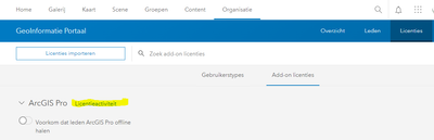

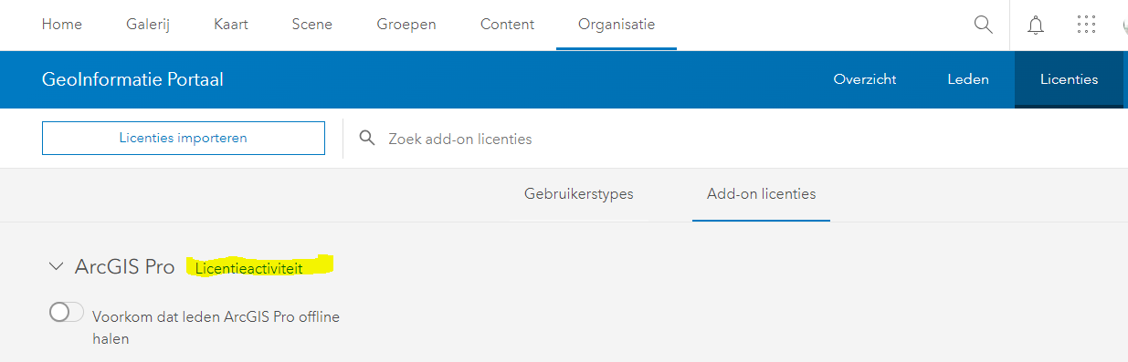

In Portal you can see the ArcGIS Pro license activity through this button:
My simple question is, can you obtain this ArcGIS Pro activity through the REST API for python?
