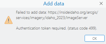

asccgm
I updated yesterday and cannot add any ArcGIS Online layers without failing. I managed to get it to log in and verify the token for about a minute, but now it's not working again. I am not sure if the update did something or something else.
