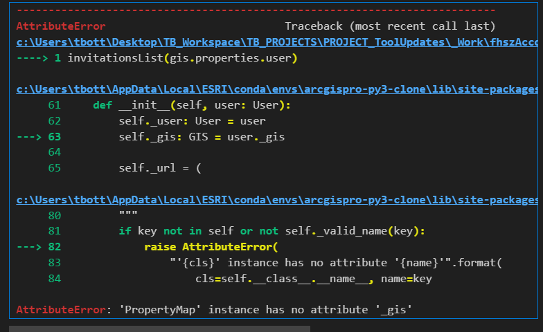

According to the documentation, the gis.sharing module, and calling the UserInvitationManager, should do the trick. However, I keep getting property map errors when I attempt to access invitations.
from arcgis.gis import sharing as GIShare
user = gis.properties.user
GIShare.UserInvitationManager(user=user)
Looking for some guidance on how to use this....apologies if I'm overlooking something obvious as I'm a bit of a novice. There's not a lot of documentation.

Figured this out. I was using the wrong type of user object and missed in the documentation the need to access the list property for the invitation manager. To find and accept all of your invitations for a user...
user = gis.users.get('UserName')
invitationManager = GIShare.UserInvitationManager(user=user)
inviteList = invitationManager.list
for invite in invitationsList:
    invite.accept()
