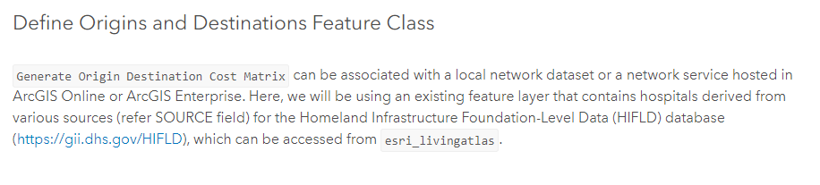

I would like to use the ArcGIS API for Python and generate_origin_destination_cost_matrix to do my calculations, but without having a publish routing/network service. Is there a way to use the API with a local network dataset in a FGDB?
The sample notebook on the developers guide site indicates that "generate origin destination cost matrix can be associated with a local network dataset" but I cannot seem to find any documentation that explains this further.

This works fine without arcpy, however I can no longer use the routing service I published, it had to be removed. The Guide to Network Analysis link above indicated that Generate Origin Destination Cost matrix can be associated with a local network dateset OR a hosted service. So my question is more about how is this "association" done? Or am I misunderstanding the guide?
