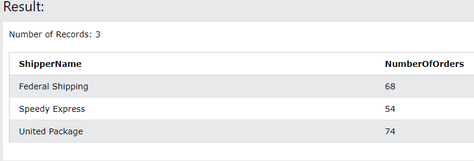

Using Group By in SQL looks something like
How do I get the count as a field so I can use it?  Most SQL examples have count(field) as field but I can't get that to go and not really sure where to put it.  I got the trick to add ObjectID.
