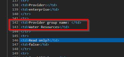

another way to get the providerGroupName using SAML is:
- get the group id using groupid properties
- build this url: group_url = f"https://portal_url/webadaptor/sharing/rest/community/groups/{group_id}"
- using urllib find the ProviderGroupName tag value from response.

UPDATE: I couldn't wait trying it, even though it is late evening here. I get the information I need with the solution provided. Thanks again!

ChrisBeaudette
According to this thread this is a confirmed bug, but that page does provide a workaround for getting the group name via the python API:
from arcgis.gis import GIS
portal_url = "https://myorgportal.company.com/portal"
portal_username = "admin"
portal_password = "foo"
ent_gis = GIS(portal_url, portal_username, portal_password, verify_cert=False)
editing_groups = ent_gis.groups.search(query="tags:Edition",sort_field="title",sort_order="asc",outside_org=False)
for editing_group in editing_groups:
    edit_group = ent_gis.groups.get(editing_group["id"])
    print(edit_group.providerGroupName)
I confirmed that this works with ArcGIS Enterprise 10.9.1.
