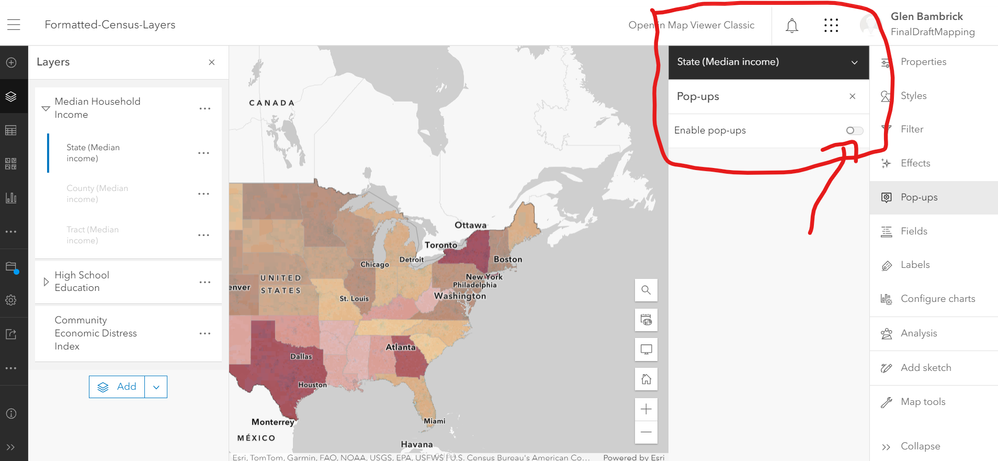

2. However, if we look at the webmap, the popup for this layer is disabled. When I turned it on the PopUp doesnt display fields it displays a graph (well, 2 graphs that you can use as a carousel). Are you looking to remove the graphs?
