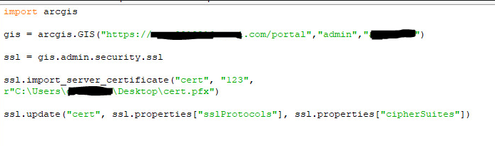

I was able to do that for Portal for ArcGIS as shown below:portalcert.PNGportalcert.PNG

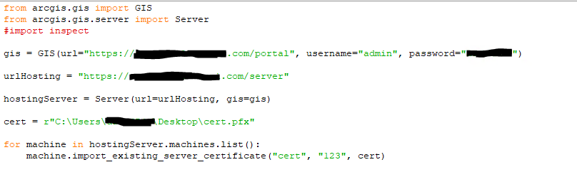

I was also able to import the certificate to ArcGIS Server as shown below:

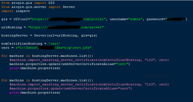

However, I can't find any documentation about updating the Web Server SSL certificate for ArcGIS Server.
Please note that I tried the following:

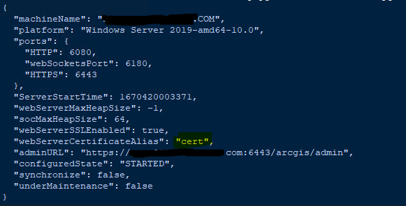

I seem to have been able to update the Web server certificate, however, it doesn't seem to persist for some reason:
The result of the first loop is the changed certificate:

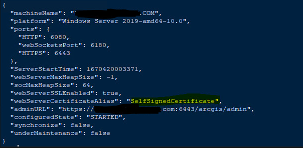

However, when the loop finishes, it seems to be reverted back to the previous certificate, as this is the result of the second loop:
Please note that I restarted the ArcGIS Server service.
