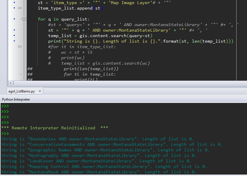

RobertHolliday
Sorry I did try what you suggested after taking a second closer look at what you suggested.
Screen Capture

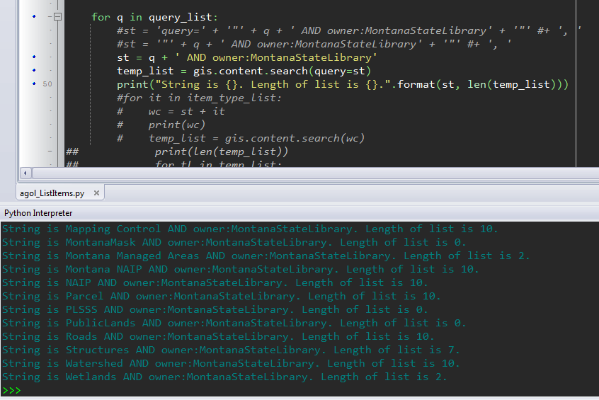

RobertHolliday
Success!  I am not sure I would have ever figured out to enter an unquoted string.  Thanks to both Joshua Bixby and Dan Patterson for the help.
Screen Capture
