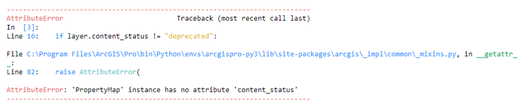

Kalu_Ribush
Hi @ChristopherCounsell .  Thanks for response
Unfortunately I get this error message:
Any advice apprreciated.  Can I get it to ignore the error or skip that record?
ChristopherCounsell
MVP Frequent Contributor
Sorry I didn't test the script, but the content_status property is what you are looking for. It's likely not there for those without the property so you need to update script to handle it.
Try this one. It'll loop through and return the content_status. It can be empty, org_authoritative, deprecated, etc
