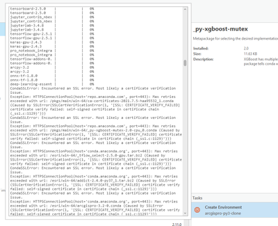

MK13
@DanPatterson  For some reason I am unable to clone. Does it require administrative rights? I don't have admin access to the machine that I am utilizing.
DanPatterson
MVP Esteemed Contributor
arcpy is locate in this path
C:\... your arcgis pro folder .... \Resources\ArcPy
the arcgis module is located in...
C:\... your arcgis pro folder .... \bin\Python\envs\arcgispro-py3\Lib\site-packages\arcgis
If you don't have admin rights you may not be allowed to do a lot of things. contact the people that restrict you
