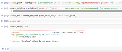

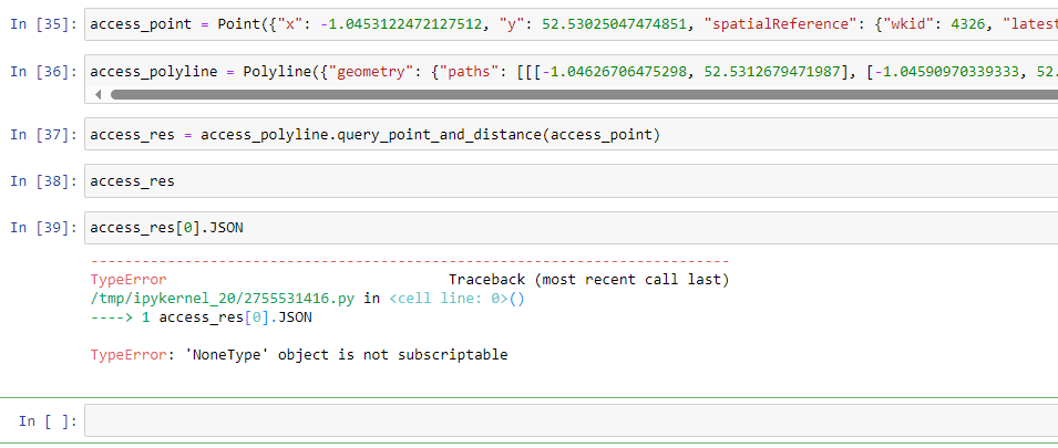

so this sounds simple and if i use Near in Pro it is but i want to create a AGOL python notebook to run once a day to loop over any point features created that day and get the closest XY to a feature service of polylines (50k features)
i tried following the example here Part 3 - Spatial operations on geometries | ArcGIS API for Python
but even if i just manually populate the geomenty json for both the point and the polyline it returns None
DavidPike
MVP Notable Contributor
Are you using a standard Notebook?  I think you'd require an Advanced Notebook type to then be able to import the required ArcPy module.
access_res.type is probably returning none

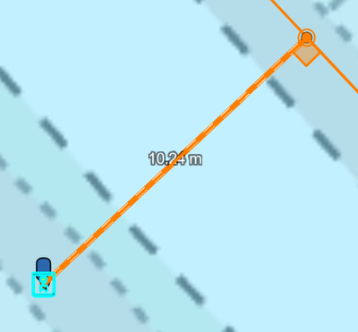

this is the code's closest point
but i was expecting this as the closest point:
and this is the distances returned:
i also found that post and it suggests that the distance is the second item so
0.001106969364200805
