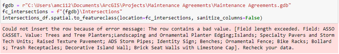

I tried to export a Spatially Enabled DataFrame to a feature class in a fileGDB and got an error of field length limit. I could find more information on this page (https://developers.arcgis.com/python/guide/introduction-to-the-spatially-enabled-dataframe/). I thought the maximum length for a text field is 2,147,483,647 characters in geodatabases. The target field value length is only 275. What is the explanation for the error, or what is the field length limit when using the function ".spatial.to_featureclass"? I hope there is a direct solution such as setting the limit in the function, or I will try some workarounds. Thanks!

I recently ran into this problem as well. I have a layer from AGO that contains a field with a text length of 2500. Currently there is only one row with > 255 characters in that field. That row isn't exported using to_featureclass method and generates the following error.
It doesn't matter if i overwrite or sanitize columns, i always get the error above. The field in the resulting feature class has a length of 255 which seems to be the cause of the error.

If you export it to a shapefile, yes to 255. File geodatabase can contain much more.

I can confirm this also happens when exporting to a FGDB.

I can also confirm that this happens when exporting to a file geodatabase. did anyone find a workaround?
