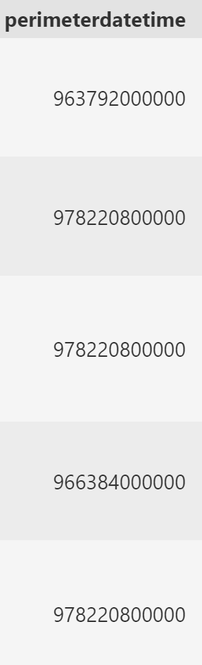

Unfortunately, this is changing the DateTime field into a format I can't understand or parse. Below is my code, and the resulting DT field. The original field is in the routine Esri DateTime format.

This is the UNIX timestamp/epoch in milliseconds. If you want to use the FeatureSet as a dataframe the easiest way is the spatially enabled dataframe.

The conversion from UTC timestamp to the datetime object is done under the hood.
If you still want to use the GeoDataFrame from the geopandas module, you have to write your own conversion implementation. The to_geojson property of the FeatureSet is going to reconvert the datetime object back into an UTC timestamp. This seems a little bit awkward. The following function is converting the UTC timestamp into the ISO format string, because your code reloads the GeoJSON into a python object again. Furthermore, the to_geojson also encodes your strings into unicode escaped characters ('\uxxx') - I love our German Umlauts. I would suggest to stay away from the to_geojson approach.
