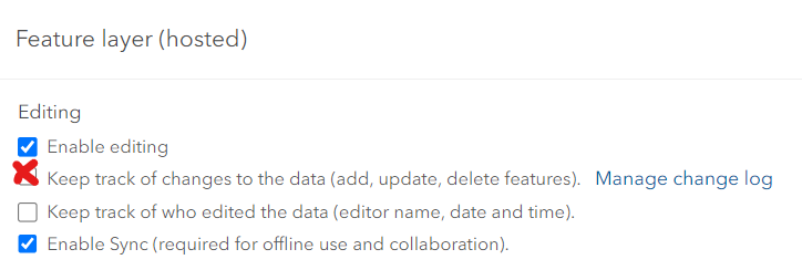

Hi @MaryGraceMcClellan
Have you checked the 'keep track of changes to the data' in your feature service settings?
It would also be very helpful to post the code you are attempting.
