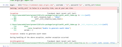

ellipsol
I started seeing this same issue that started yesterday. Do you have a solution or work-around? I've been using this calls in scripts for more than a year, no problem until now.
ellipsol
My proxy changed and that was what was causing this error. It is resolved now.
Danfranco
where are you specifying the proxy changes? I have a very similar issue, but I know nothing has changed....
ellipsol
I had a proxy in my browser settings. My employer stopped using that proxy though and it caused these errors. It was fine once I turned off the "Manual proxy setup" in Chrome. These days I use a profile to log in. You can set up in a notebook from Pro.
